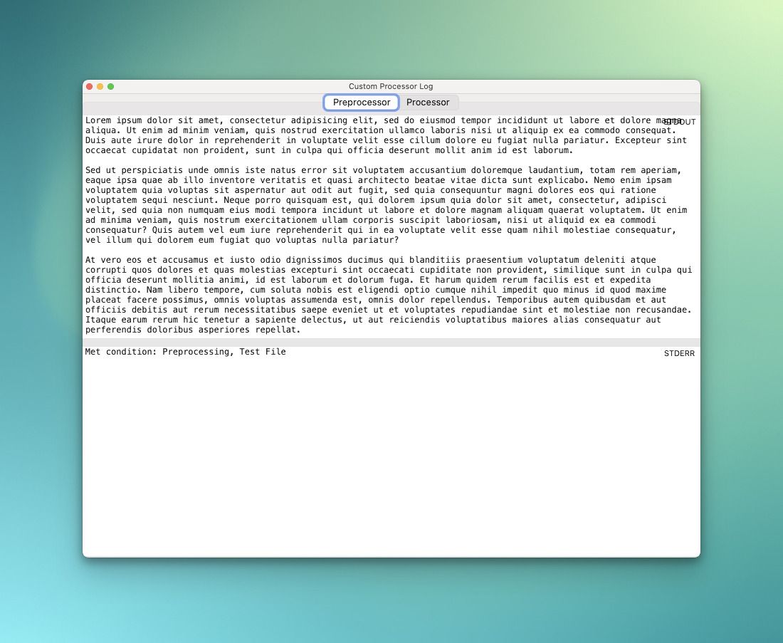

Troubleshooting Custom Rules
Custom preprocessors and processors get their own log interface. Select Help Show Custom Rules Log to open the window. This window will display a colorized log showing which rules matched and what commands they run.
