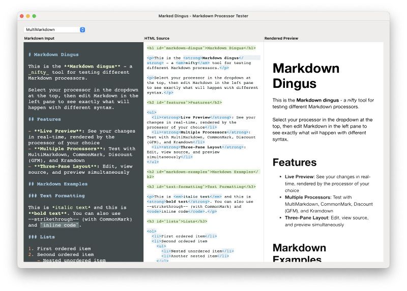

Three-Pane Layout
The Dingus window is divided into three synchronized panes:
1. Markdown Input (Left Pane)
  • Syntax Highlighting: Your Markdown is highlighted with colors to make structure clear
  • Live Editing: Type and see changes reflected instantly in the other panes
  • Large Font: 21pt Menlo font for comfortable editing
Options dropdown (upper right of the left pane): The Options menu lets you toggle:
  • Show line numbers: Displays a gutter on the left with one line number per paragraph (wrapped lines count as one line).
  • Show invisibles: Shows spaces as mid-dots (·), tabs as a rightward arrow (→), and newlines as a carriage-return symbol (↔) in a light gray so you can spot stray whitespace.
  • Highlight gremlins: Puts a light red background on non-ASCII characters (e.g. curly quotes, emoji) and a dark red background on problematic invisible characters (e.g. zero-width spaces). Normal tab and newline characters are not highlighted.
Your choices are saved and restored the next time you open the Dingus.
Find bar: Press ⌘F to show the find bar below the “Markdown Input” label. You can search and replace in the editor, use ⌘G for Find Next and ⇧⌘G for Find Previous, and replace one or all matches. Press the close button or ⌘F again to hide the find bar.
2. HTML Source (Middle Pane)
  • Generated HTML: See exactly what HTML the selected processor creates
  • Syntax Highlighted: HTML is color-coded for easy reading
3. Rendered Preview (Right Pane)
  • Live Preview: See how your Markdown will look when rendered
  • Emoji Support: GitHub-style emojis like :zzz: are converted to images
  • Auto-scrolling: Automatically scrolls to show your current edit position
